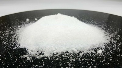

As a break from cutting and welding I thought I'd clean some suspension bits up. I've tried molasses and CLR for rust removal but molasses stinks and CLR is quite corrosive so this time I tried Citric acid for the first time and it really :D works
Same stuff they use in bath bombs so is safe and at about £6 for 1kg it will go a long way.
The rear shock absorber brackets were pretty grotty after a scrape and a wire brushing
About half a cup of the powder in a bucket of hot water and it's fizzin'
