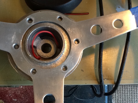

I spent ages trying to find a steering wheel boss to fit. Turns out that the van is the same as a Ford Capri / Anglia / Cortina. The boss I found didn't match the steering wheel PCD I had... so ended up butchering another boss to act as an adaptor plate.
I now know you can buy these direct from car builder solutions.

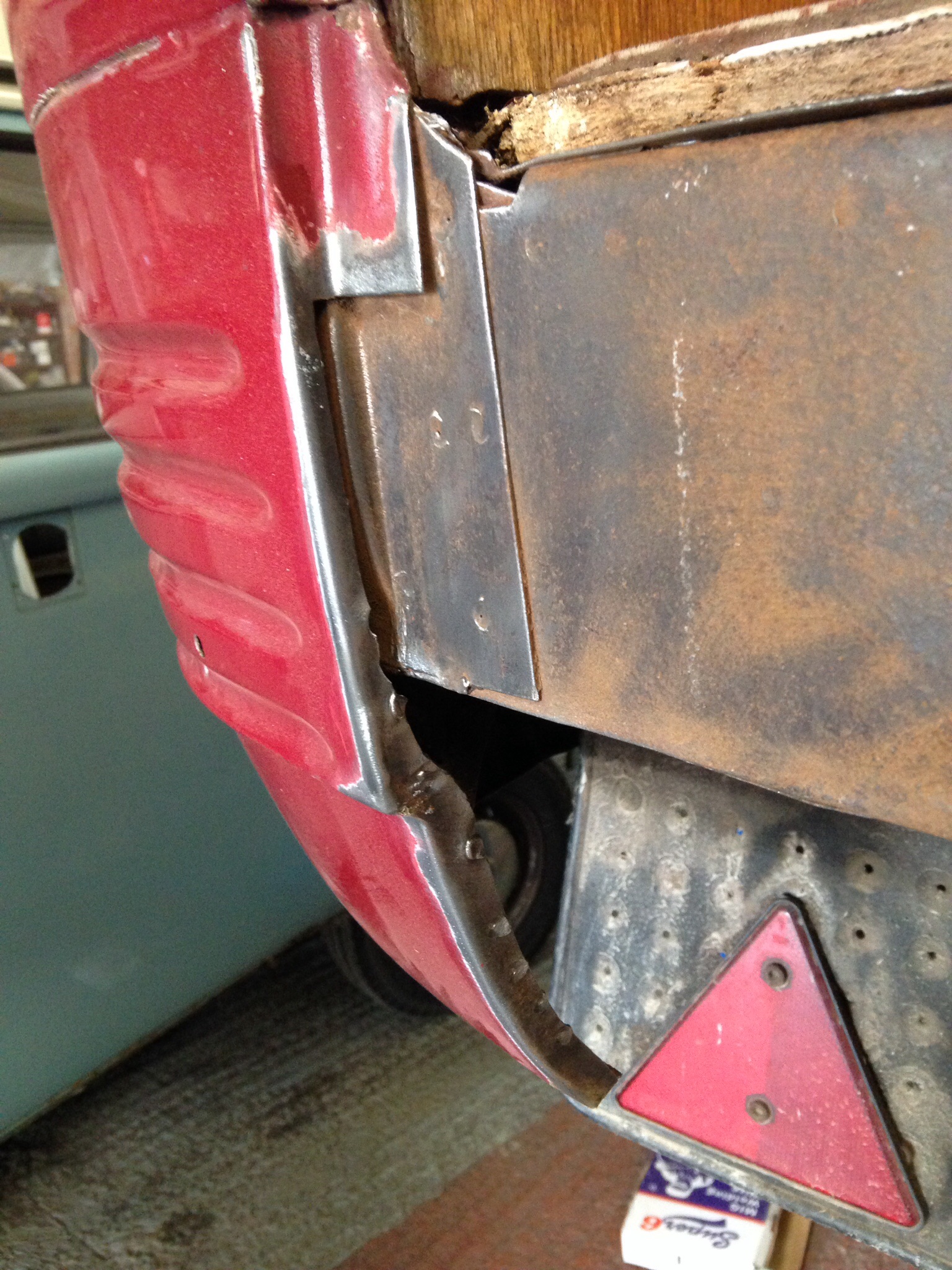

Time has come to address a few minor rust spots in the snail. The inner front sills, rear arches and the bottom of the front valance all need attention.
Spent the weekend doing 'exploratory' surgery. Found green shield stamps and tiger tokens in the front valance...
Thankfully the van must have been wax oiled from new as the corrosion so far seems to be very localised.
