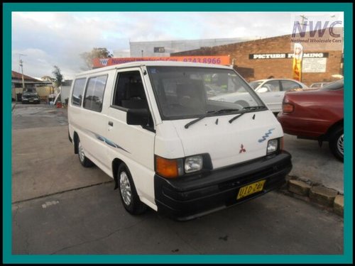

Some time back I finally retired my trusty rusty Datsun Sunny Wagon, at 590,000 km. Rust was becoming an issue, mostly cosmetic, but I was needing more space for moving things, which was the original reason I bought the Commer. I needed a van and ended up getting a 1993 Mitsubishi L300 van. I still intend to push on with the Commer, I just need something to bridge the gap.
Now before I get branded a traitor, Let me explain that it isn't as bad a decision as you might think. Firstly and most important, it isn't a VW. Secondly It was cheap, running and registered at the time. Thirdly, it is a distant nephew to the Commer. Let me explain, as we all know, Chrysler/Dodge took over from Rootes many years ago, then here in Australia Mitsubishi took over the operations of Chrysler/Dodge. So I consider my L300 the Great Nephew of the Commer. Let’s be honest, all families have a relative that they don't talk about, marrying a "commoner" and producing offspring that were often disowned. Well that's me at the moment.
The L300 works well, though the torsion bar front suspension give a ride on bumpy road's not to different to what a Joey in a Mother Kangaroos pouch must feel like.

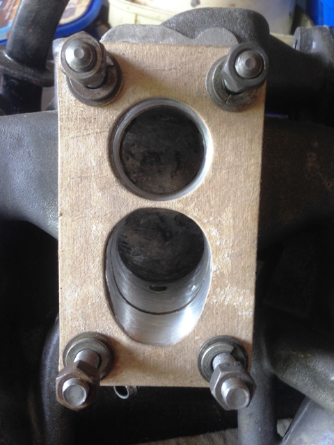

The short motor was rebuilt, new pistons, bearings etc and is basically a stock short motor built by a specialist. The original head was beyond repair and replaced with a new one that is bog standard. I contacted a company call Camtech here in Sydney as they had an upgraded cam profile that gave good improvements in low down power and fuel economy, while retaining a smooth idle, sounded perfect to me. I had also bought a set of extractors with 2.25” outlet plus a 32/36 DGV Weber and adaptor to suit the standard manifold to get started. I cleaned up the manifold with my die grinder, as the production casting was very poor and rough, plus cut more of a tapper into the adaptor plate and manifold to reduce interference to flow for when the second barrel opened up.
