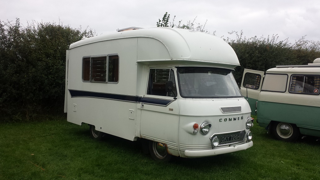

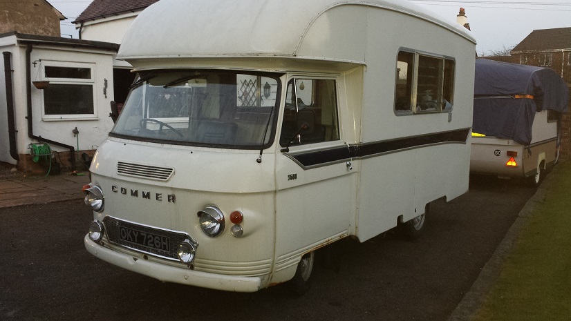

May I introduce Jim
The Jennings belonged to a Guy in Scotland and we had seen it many times on our trips up there.
The Guy is called Jim so that’s why we named the van Jim.

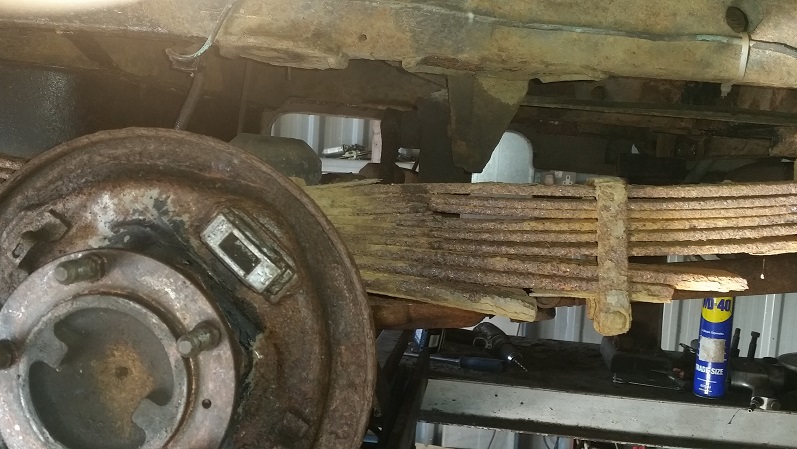

Jim, the Guy took Jim the Jennings in for it’s MOT in May this year and Commers being Commers it failed on Brakes, broken rear springs and would you believe corrosion!

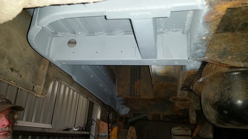

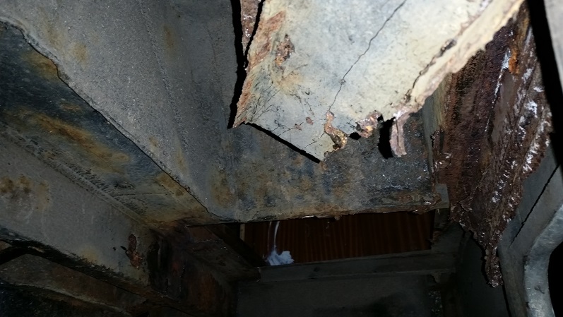

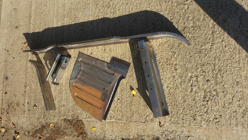

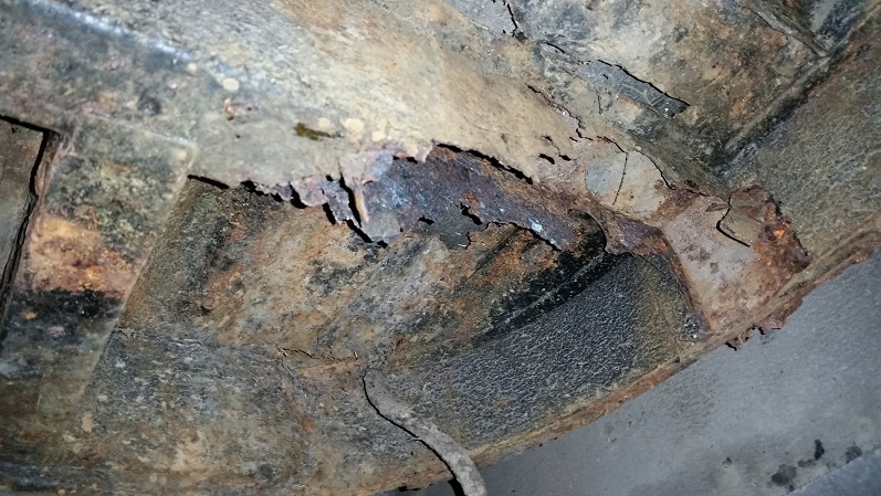

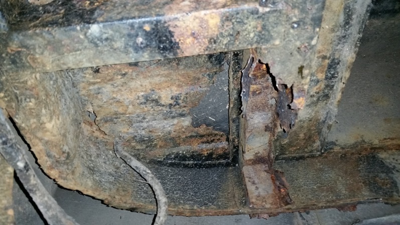

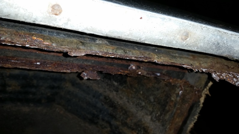

We then set about getting him ready for a new MOT. We took off the broken springs then set about cutting out all the rust.
Starting on the near side rear corner We ended up with this.

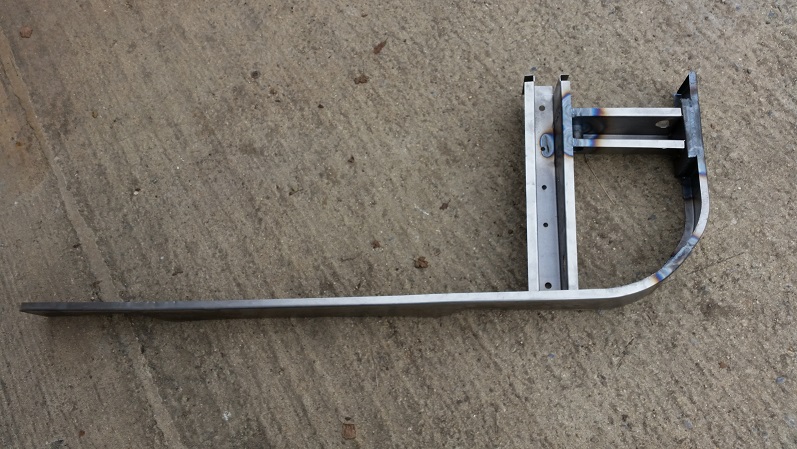

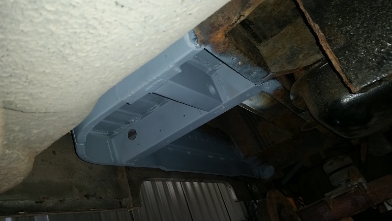

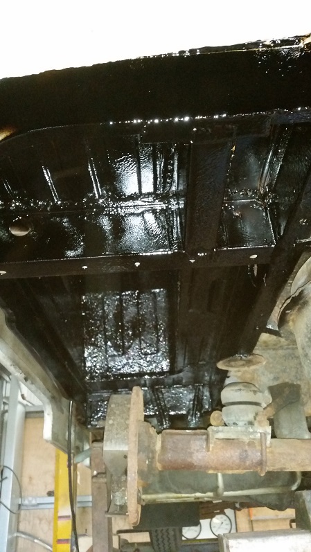

Then replaced it with shiny new panes made by Mr M
All welded in place and a nice coat of Shutzs to finish off.

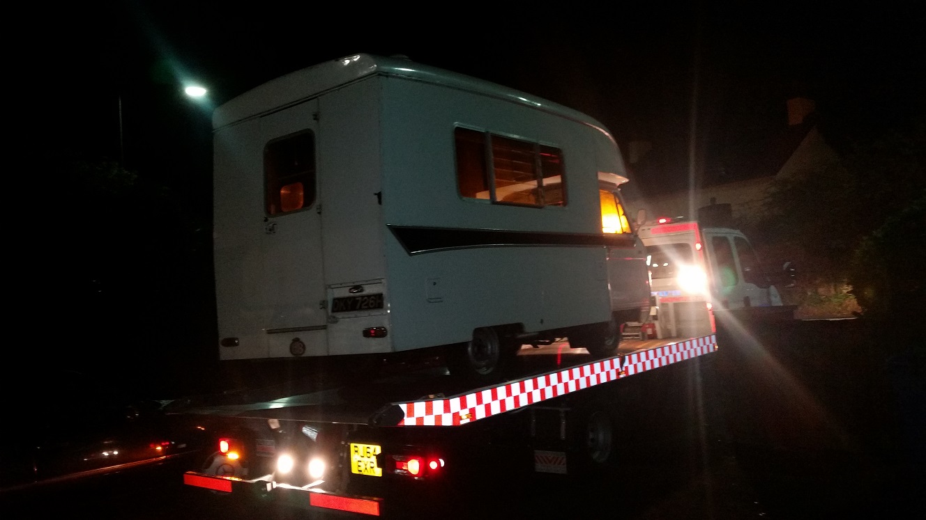

On our way home Jim been a Commer he ended up on this
Yes muck in the fuel line & carb:(

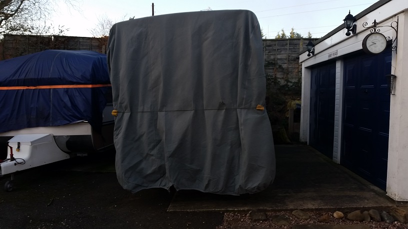

So got him home, put a cover on him and that where he has stayed until today when I had some spare time so thought I would do a little work on him :)

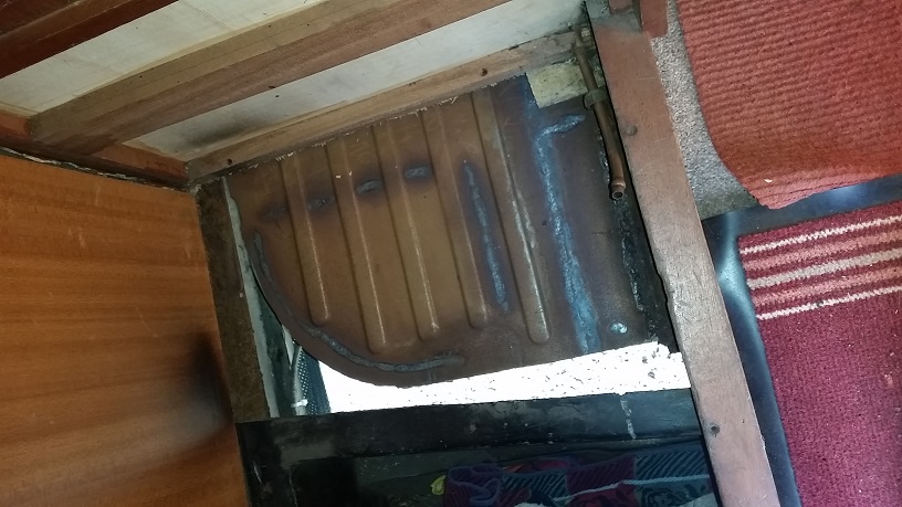

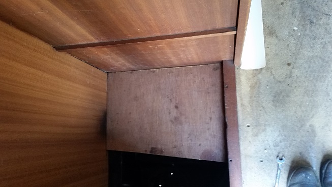

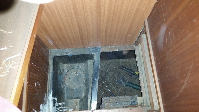

First I thought I would replace the bottom of the wardrobe with new flooring,

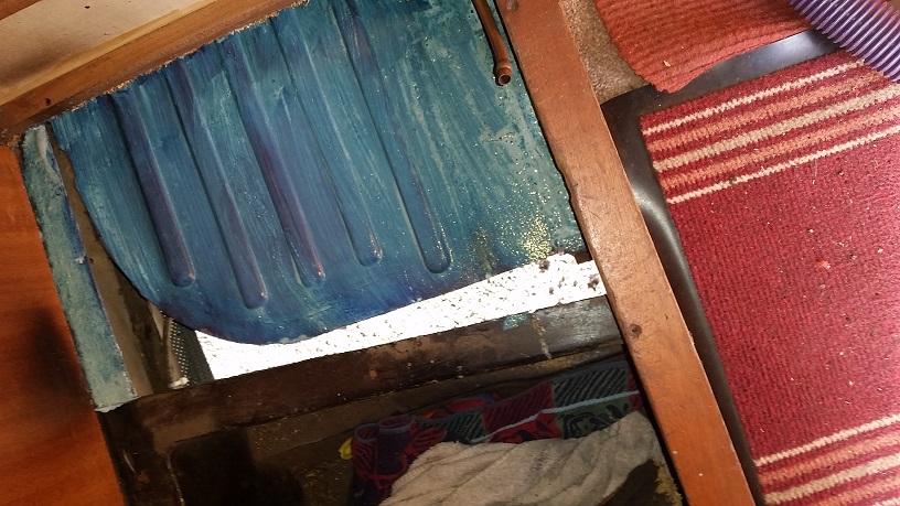

I give the new metal work a coat of Aqua-steel:p

So work stopped and I put the cover back on :)

Not a good idea to put aqua steel on new metal, it just peels off. I found out to my cost[B)] works brilliant on rust, as a converter.
Hi Martin
Yes I know but as the new metal was covered in surface rust I thought it would stick to that and protect it:p

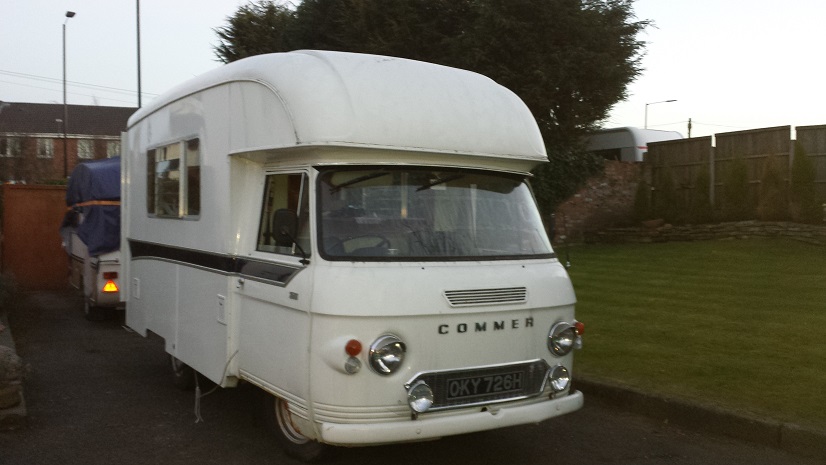

Well I thought is was about time I pulled my finger out and woke Jim up from his slumber. So we took his winter cover off and moved him down the drive :)

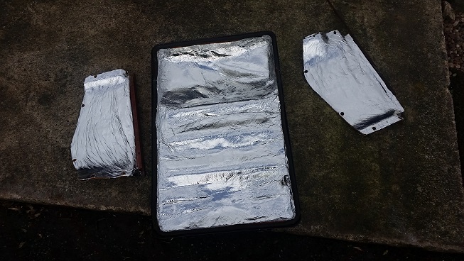

Fitted some sound proofing & heat shield to the engine covers,
Fitted him all back together :)
Fitted new Wardrobe floor,

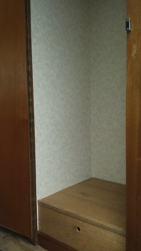

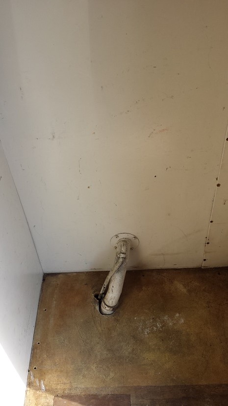

Time to start on the en-suite :D

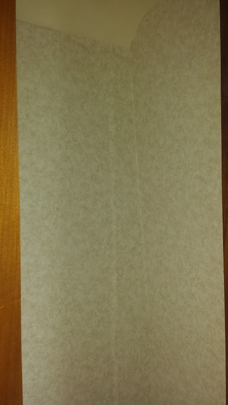

Used some Caravan Wall Paper I got from Ebay several years ago knew it would come in one day

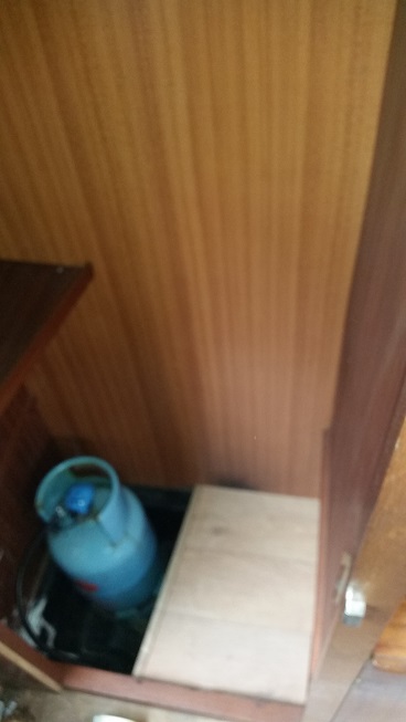

Fitted a false floor to hide the fuel pipes
Then Finally fitted the portaloo :D
