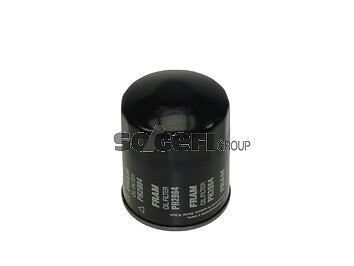

Morning , hope all is well ! I have been out a couple of times - 17 and 27 miles and hoping for about 70 mile return tomorrow ! Can you please advise me what oil and filters to use in engine , gearbox and dif ? my oil filter is not readable and want a replacement before taking it off to measure . Anything special ? Thanks , Ken-n-Trish

20/50 engine oil for both engine and gear box, I've started using Duckhams rather than the cheap stuff as I find it maintains the oil pressure better for longer. EP90 GL4 for the diff
Here's a list of filters to choose from, some I couldn't find
And this is the one I used last time
