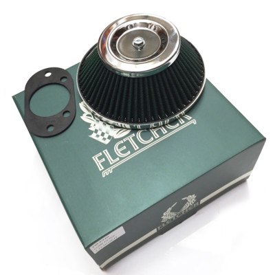

A K&N cone for a 1275 Mini is usually the filter of choice on this conversion.
Or this one, a bit cheaper than the K&N
It's a tight fit but they will go in.
TIGHT FIT! I cannot for the life of me get this fucker in! I don’t want to break it so I’m just staring at it now
I rerouted the air filter down side of the rad so it sat in front but to the side of rad. Silicon pipe and 5m waste pipe bends.
Yeah I nearly resorted to that, however I have had success after about 2 hours of faffing!

Well done. Quicker than me trying unsuccessfully to attach some pics of reroute for you. Managed to resend my message though. Clever me lol.
It’s so easy for you! Honestly this is as tight as a nuns vagina. Was an absolute nightmare but it’s in now and hopefully I won’t have to take it off for a very long time
I was being sarcastic about praising myself for failing pics lol. By the sounds of it it’ll never fall off so that’s a win :)
Tight fit? just well designed;)
To honest that is the easiest way to do it (really) I used a combination of house gutter elbows, flex pipe and a K&N element inside the (modified) air box mounted on the engine bay side panel. I tend to do things the hard way:)
