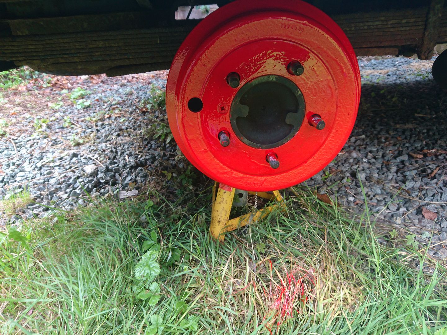

2 wheels painted and lacquered and I am very pleased with the results.

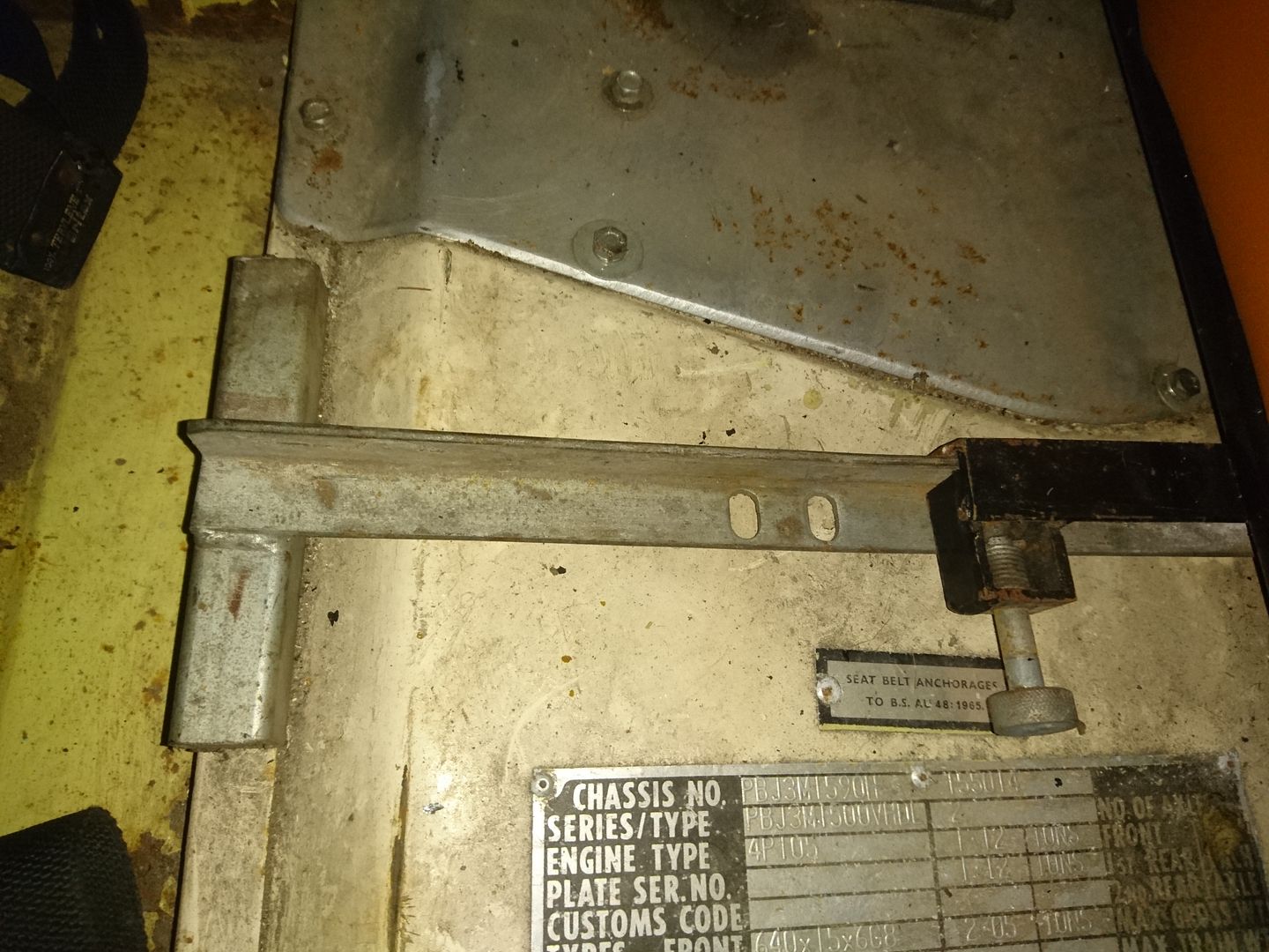

Are these original commer seat mounts?
Under the front bench seat, Should this be bolted down? There is a thread stuck up at the front but nothing for the back holes.

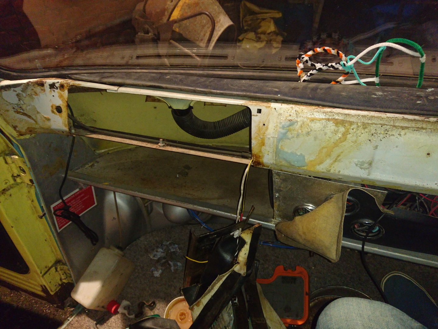

Am I missing a glove box? The was all hidden behind some horrible vinyl:
Never seen mounts like that before, must be a converters addition for a bench/bed. The brackets for ordinary cab seats are simple saddles that go over the frame, you can see the four holes for them on the front of the wheel arch.
There is normally a blanking plate covering that hole, for left hand drive dash. You could fit a HUGE stereo in there:)

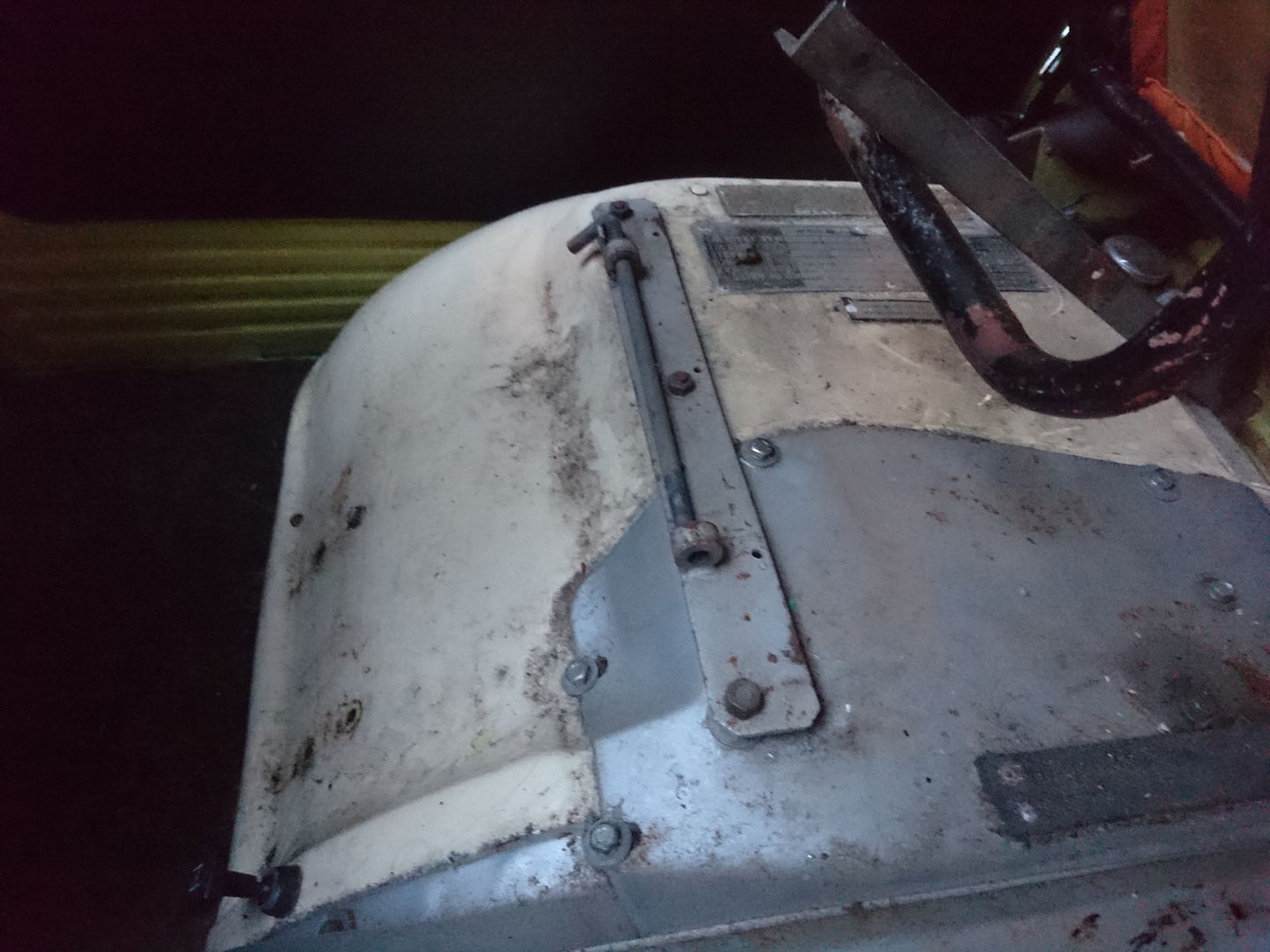

top photo is of the mounts that held own the old seats. middle photo is of the rear of the bench seat, it extends but has holes and is as though it should be bolted down.
I assuming the normal commer seats that clamp on the front of the wheel well have no other fittings to secure them?

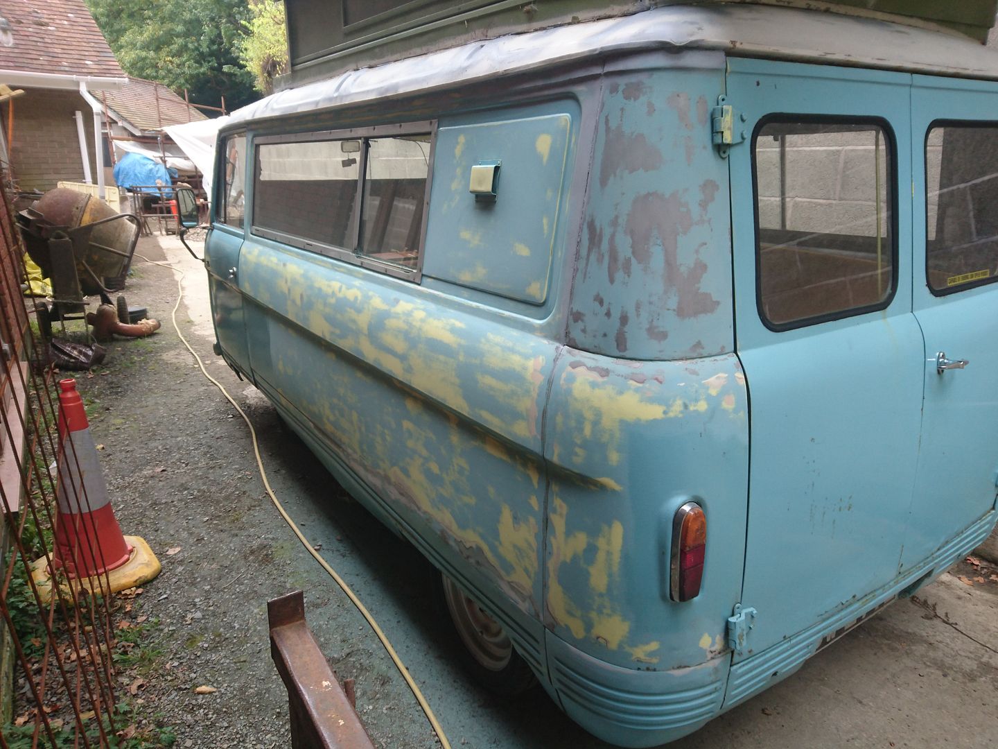

Removed all grills, lights etc today (only windscreen and rubber left in)
Started cleaning up the cab doors which were neglected last time and have ordered new inner and outer panels.
