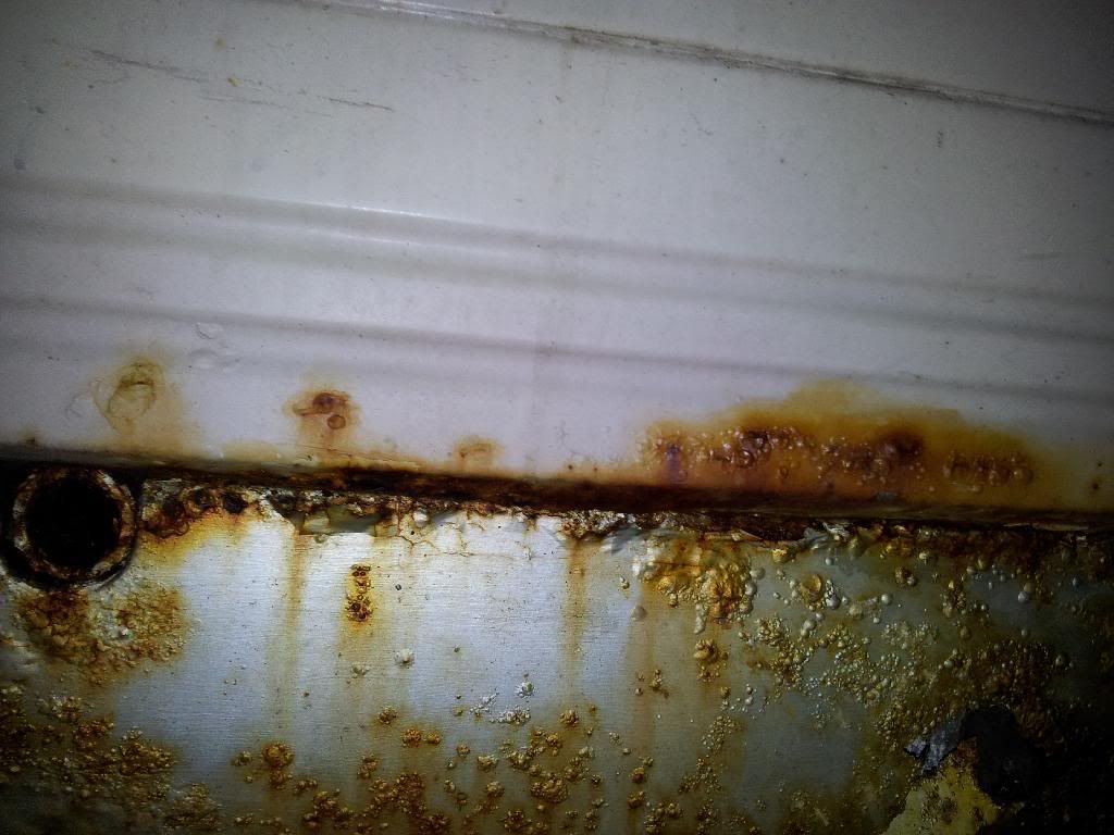

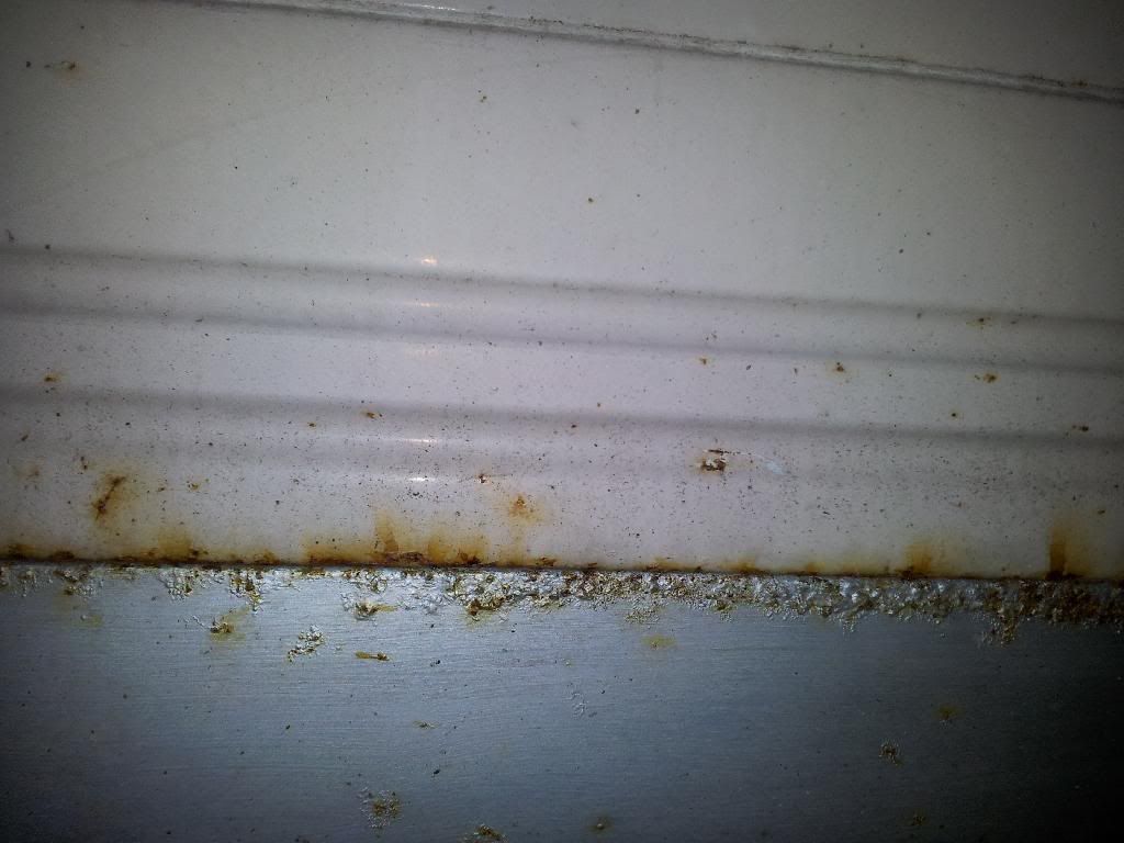

Next, look for rust at other panel joins and seams.

Keep looking.
Rust that looks like this:
Is often hiding rust like this:
Which leads to more rust like this:

These vans rust. Bad. And the rust can be difficult to repair, which means big $$$$$$ or big time (or maybe both).
Go in with your eyes open. Be honest with yourself. Anyone who goes to look at a van needs to take a screw driver, and a camera. Use that screw driver. Poke everywhere. If you see bubbles in the paint, poke. Flaky chassis, poke. Flaky gutter, poke. Take pictures of it all. Poke poke poke. Take your time. Go have a coffee, come back, poke some more.
