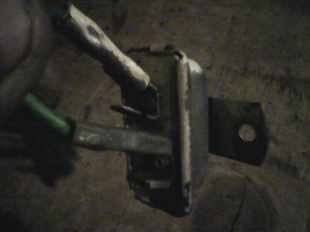

V/S is behind the dash somewhere, and controls current to the gauges.
If the voltage reg has gone the gauge will move up and down (slowly) with engine revs, you can get an electronic one off ebay for about a tenner and they are easy to fit. It may be that the tank sender is knackered, copper contacts gummed up on the internals:I
well swapped the temp gauge over and looks like that's working fine now. No movement with revs so looks like i'll have to inspect the fuel gauge / sender further.
