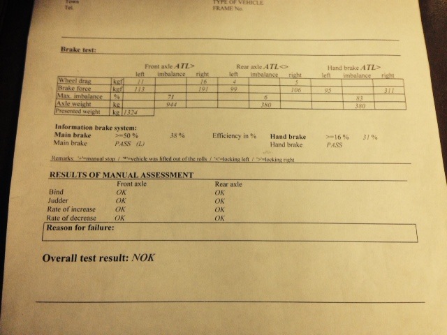

OK SO AFTER COMPLETE NECESSARY WORKS ONE THE VAN I TOOK IT FOR IT'S MOT… …….. IT FAILED..!!!!!
no big surprise there but the mot station are being as helpful as a packet of dead squirrels…
anyhow it only failed on the front brakes… so i said i would adjust them and brign it back..!!! that don't but they still wouyldnt pass it.. here are the two read outs one from first test

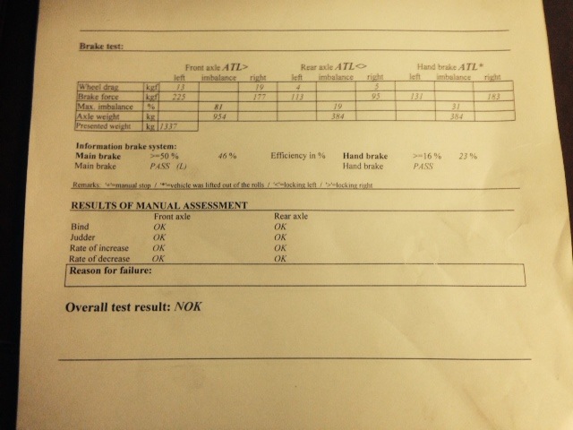

after adjustment
CAN SOME ONE PLEASE BREAKDOWN THE INformation above… I'm don't understand it..
any advice would be good
The brakes have an imbalance on the front which is greater than allowed, but they seem to be working OK, it's common for Commer front brakes to behave like this after being laid up for a while. Take the hubs off and give everything a good clean and take the rusty edge off the inside of the drums. Adjust them up, with the wheel off, giving the drum a couple of sharp taps with a hammer to line the shoes up as you adjust. When the drum locks up give it another couple of taps and take the adjuster back a couple of clicks, another couple of taps and the drum should spin freely. Then take the van out and give the brakes a good work out, they don't like being left idle so give them something to do before you take it back for a re-test.
Ok so took it to another garage who were much more helpful…. any how the brakes upfront seems to be getting better as we drive it more but the issue no lyes with the back end…it lc's up very easily.!!!!
i feel this is because it is a pick up so theres no weight load over the rear axle.. the dude in the garage asked if the comer vans were original fired with a brake balancing thing….. a mechanical arm that sits on the axle to adjust the rear brakes as the weight over the axle increases??? any one have any idea what he's talking about???
(P.S. am i able to transfer this topic into readers rides rather than the classifies section???)
They never were fitted with brake balancers. No weight on the rear can be an issue, can you load something on the back? Even if it's a couple of handy mechanics :I
My local MOT station said they where having the same problem with other classics and their answer was just what Martin suggested - a couple of burly mechanics sat in the back:)
My MOT centre never test it on the rollers - they have a device so they can test it round the yard for classics

My MoT tester used a decelerometer last time with the Beddie, as a back up, because his main brake tester (rollers) failed.
He said it was VOSA approved for use in emergencies only.
The simpler the better...
A decellerometer can be used at any time at the testers decision. On the MOT inspection sheet it says only to use roller brake tester if it is a vehicle that the tester knows wont be damaged by the rollers I.E. Limited slip diff, 4x4 or fitted with traction control.
If the rollers pack up then the decellerometer can be used for every test but only for 48 hours.
