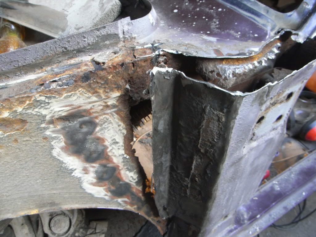

Starting at the A pillar I noticed some filler at the top. First job was to remove the windscreen, then the filler. This is what I found: :p
The closing panel at the top of the A pillar is not connected to anything, so off it came and the leading edge of the A pillar is the wrong profile, so away that came where it joins the inner wing. I also removed the new inner wing which had been welded over the rusty original.
Fortunately, I have another car which, although rusty, has never been welded and is a useful reference for making new panels.
By the way, the bodywork of this car has previously been "professionally" restored! [:0][V]

That,s shocking from a "pro" [:0]. He obviously didn,t care about the person that might be driving it [V] what would happen in a crash/roll [xx(]

The nearside is a lot worse than the offside. Do you reckon that's because of the camber of the road causing all the muck and salt to drain to the edge where it gets kicked up by the nearside wheel?
This is the weakest spot on these cars, together with the forward edge of the rear wheelarch, but other areas such as the suspension turrets, chassis rails and floorpan are perfect.
The whole job would have have been a lot simpler if the car had not restored previously!

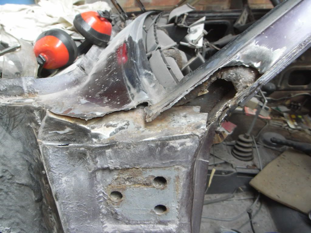

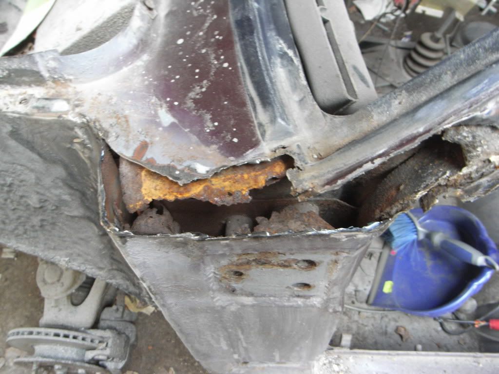

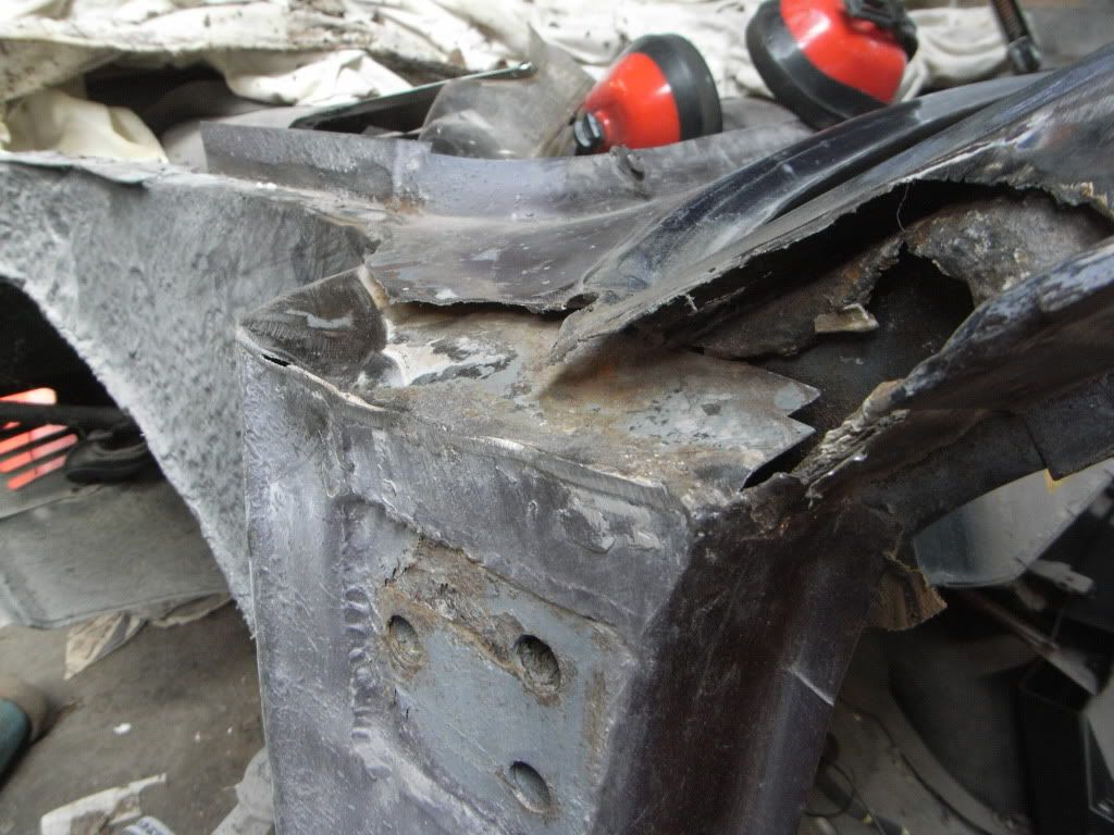

Well I've now removed much of the previous restoration and exposed the inner face of the A pillar and removed the cover cill. The results can be seen below:
That's the ecu for the fuel injection vivible on the right!
Front of cill needs repair, but the rear......
...is remarkably sound
This is the remains of the A pillar with the new metal welded onto the rusty original. I need to salvage as much of the original to make a sound replacement.
