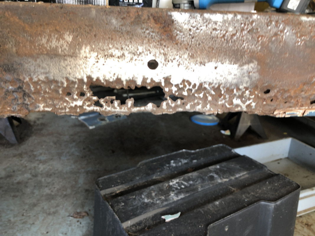

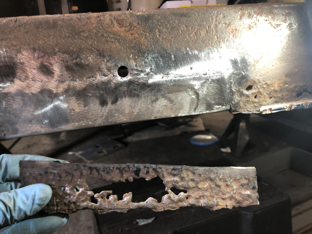

My welding and fabricating skills are pretty basic, but having watched many videos on youtube and watched people in real life so picked up my grinder and had a go. I tried the cut and butt method as demonstrated by Fitzee's fabrication
a big hole
big hole cut out and replaced with proper metal
I will get better at this. Owning a Commer, there is enough repair and fabrication work required for me to practice on!
Nothing wrong with that repair. Is that just a test panel or are you going to work your way along?

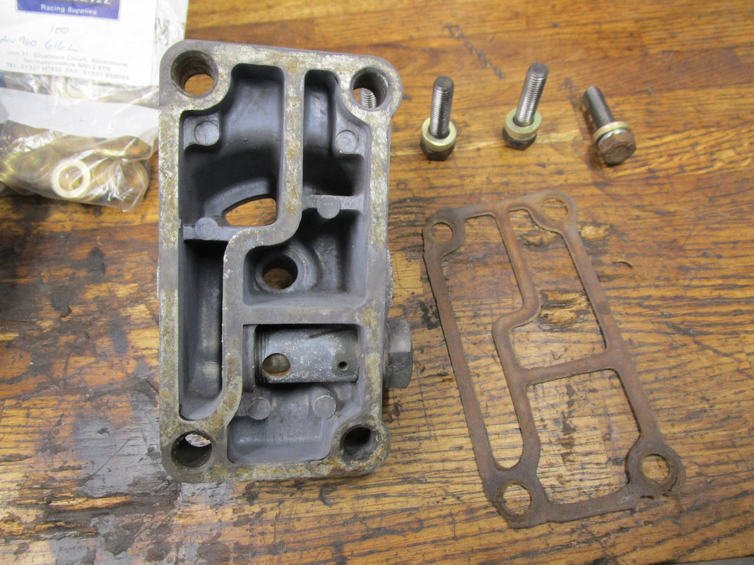

I have a quick tech question. I am about to refit the oil filter housing. As you can see from the photo below, the gasket is past its first flush of youth. Can i still buy such a gasket (I have checked Martin's website and cannot see one listed). If I need to make one, do I do so from standard gasket paper or do I need to make it from some other material such as silicone? I am guessing that as this sits on the oil system, I should avoid gasket sealant to prevent a blockage in the oil system?

If you can't find one get some Flexoid gasket paper. 0.8mm should do the trick and you will have plenty left for those other odd gaskets that creep up on you. You shouldn't need any sealant on the gasket just a smear of grease to keep it in place when fitting.

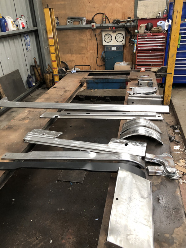

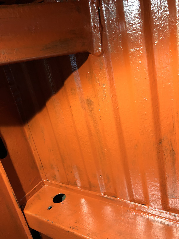

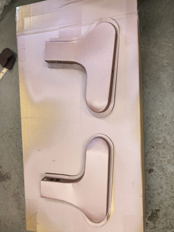

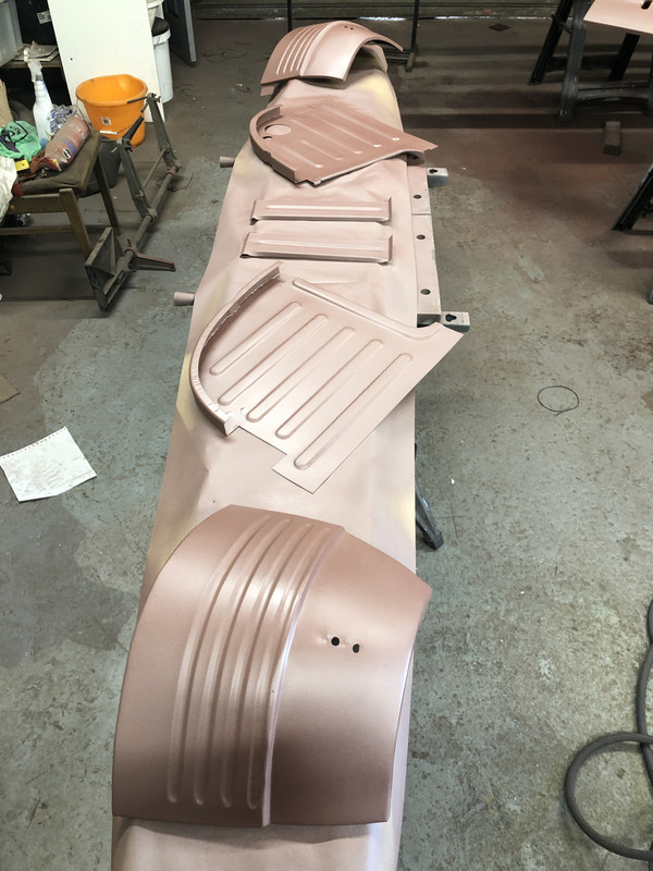

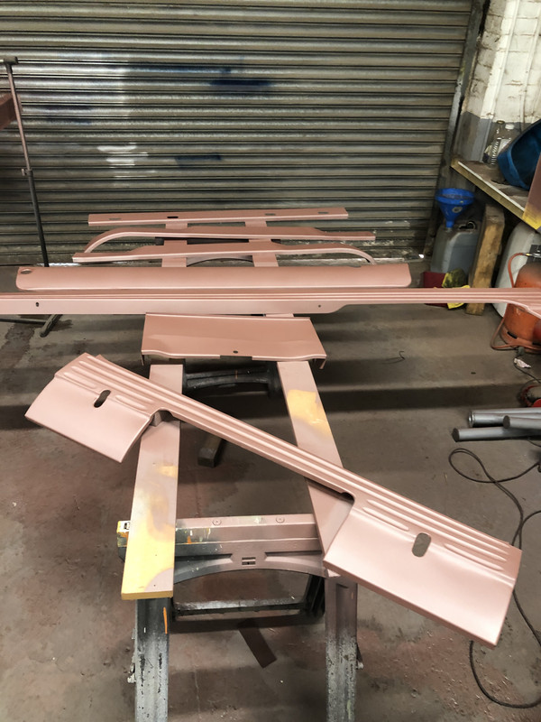

To allow myself some more thinking time (some might call it prevarication), I took the opportunity to spray the panels I bought from Martin with two pack primer. I am terrified of two pack paints, but have found a primer at rustbuster which is two pack but does not contain the nasties of usual two pack paint. Unlike most primers, it is resistant to moisture, so panels won't rust before the top coat goes on.
I donned all the recommended safety gear
and put plenty of paint on

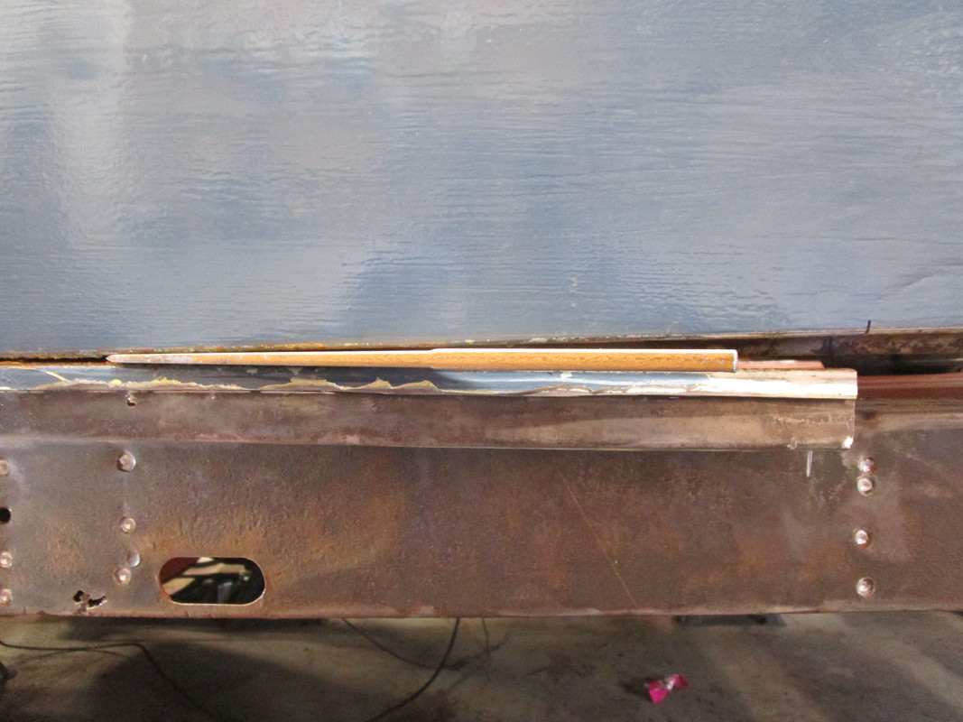

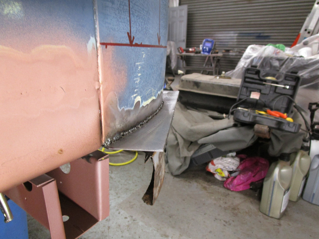

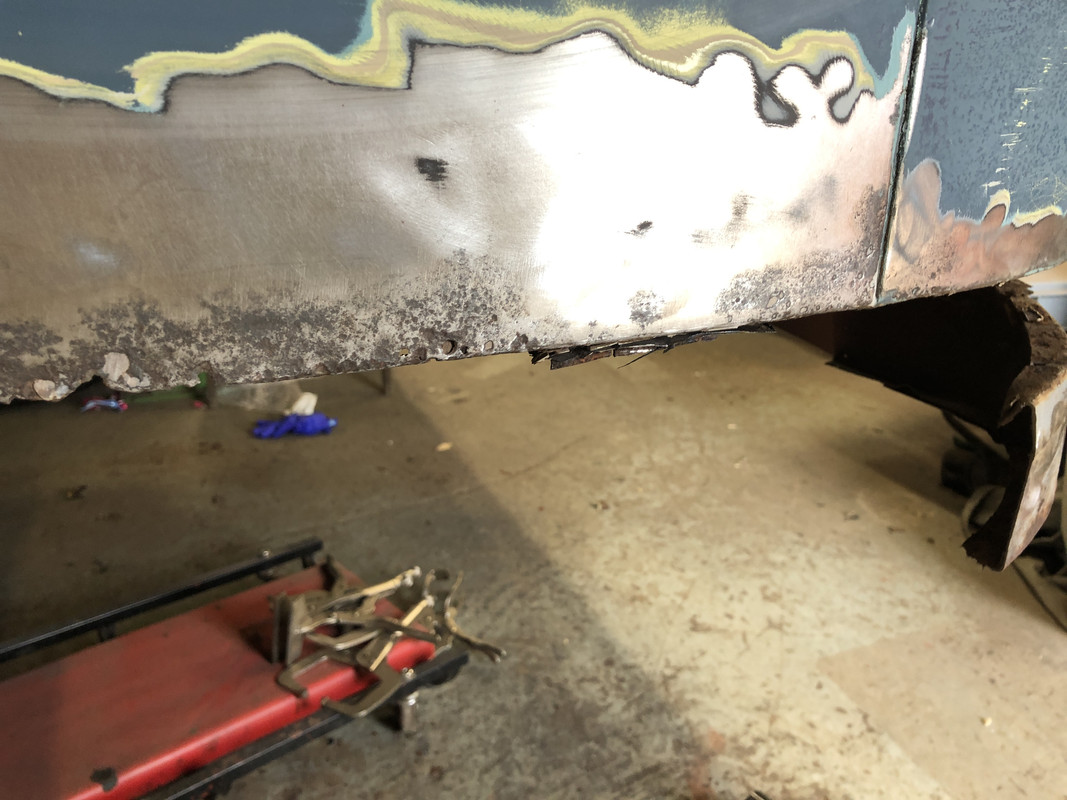

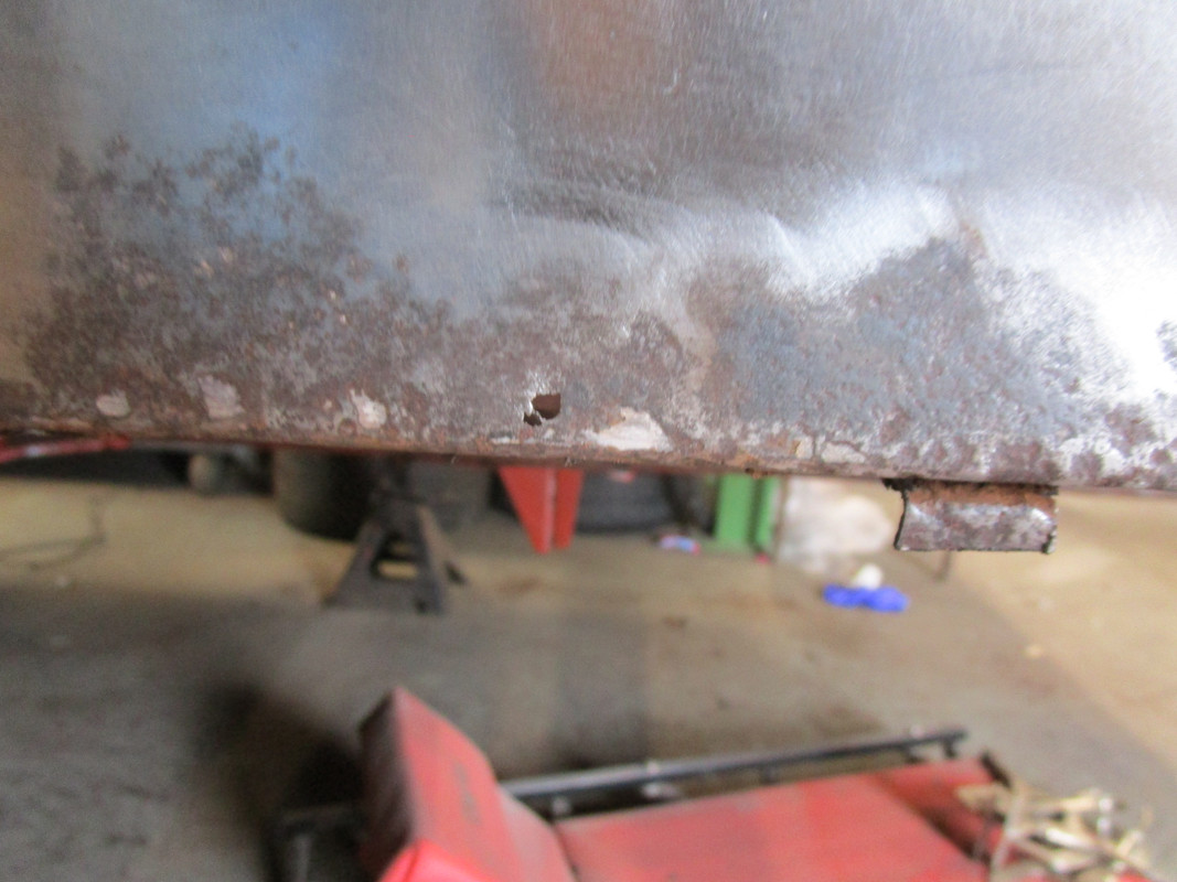

The bottom edge of the bodywork above the rear wheel is pretty frilly. also, the return lip has long since departed.

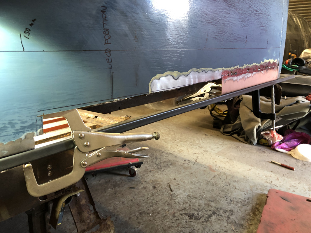

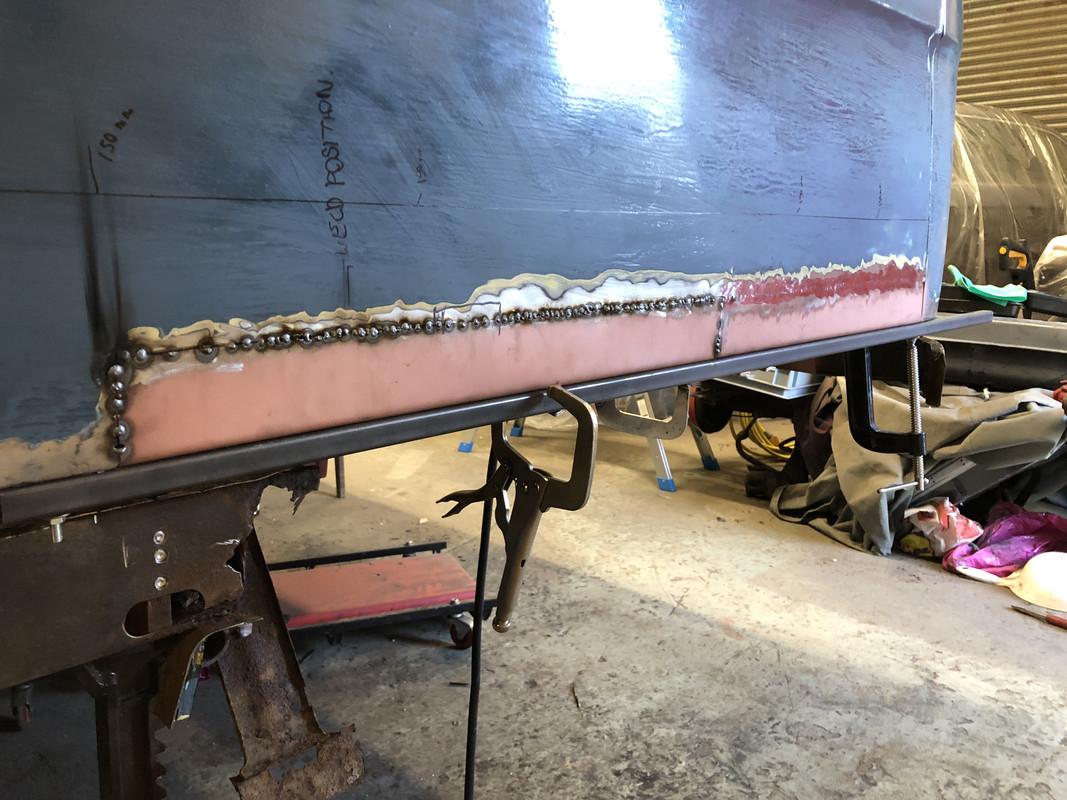

You will see in the pictures that I have drawn a line on the bodywork 150mm above the line of where the bodywork should be. I did consider using this as the reference for replacement metal, but also realised the panel is very stretched in this area, and has a lot of oil canning. So i kept the line as a reference, and clamped a piece of box section in place to replicate the line of the lower sill, and added new metal work to align with that.

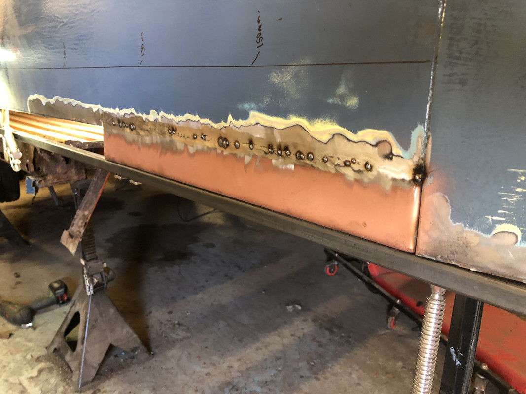

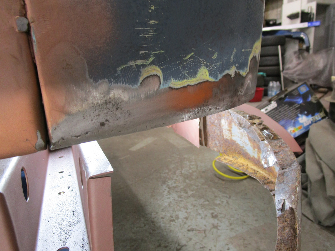

First I cleaned the corner up
Fabricated a new panel

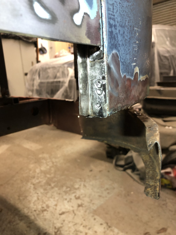

Clamped box section in place and welded new piece in place.
And another piece
These sections have straightened up the panel. I have ended up with one high spot, but oil canning has been eradicated, and I think I have far more of a chance of the lower sill fitting.

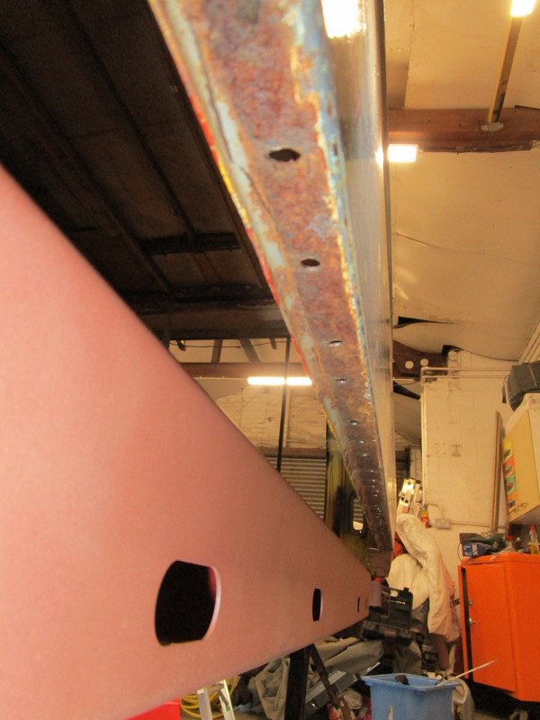

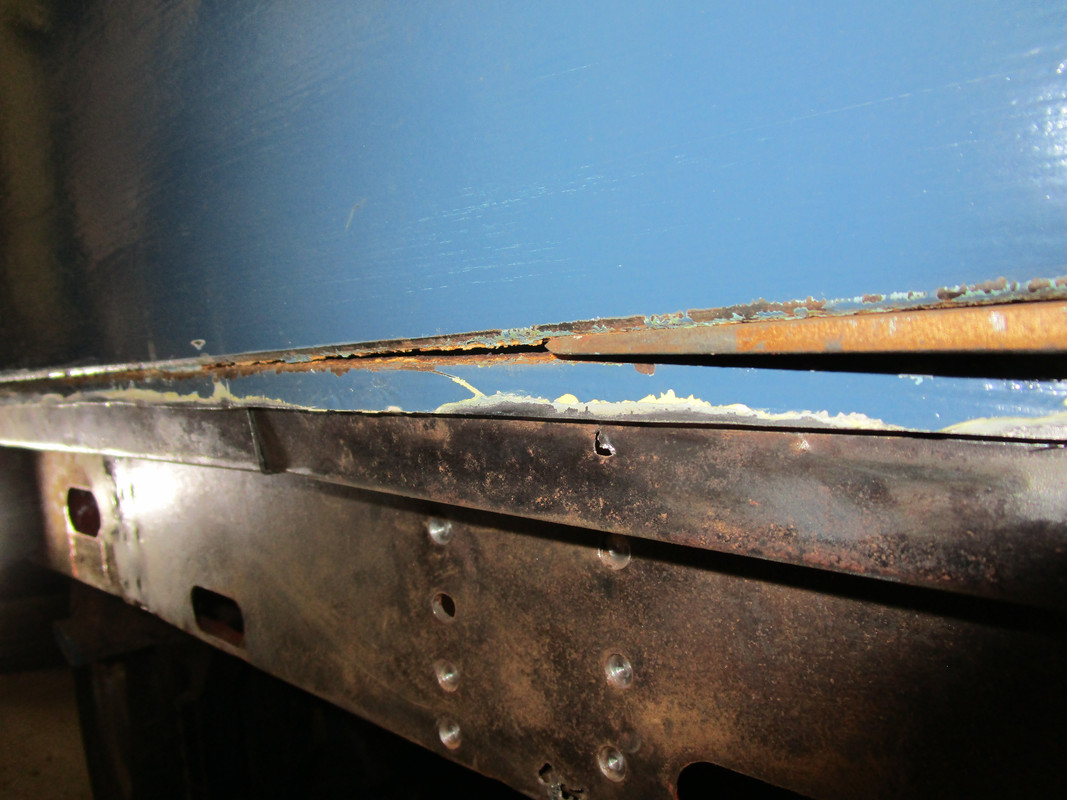

The sketch from Panky about gave me plenty to think about. Given the floor next to the sill needs repairing, and after a closer look at the inner sill I decided to replace rather than repair, I have decided to go with a full repair.

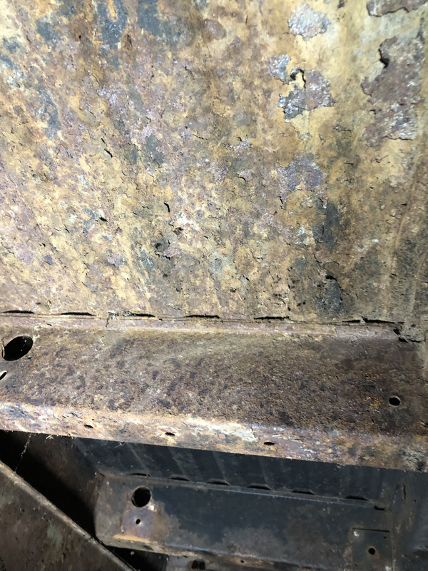

The pic below shows the condition of the floor, and showing where I have drill spot welds out.
Inner sill had lots of areas to repair
So, once the spot welds and floor was cut out it was time to separate the sill from the bodywork. It was patient work with the chisel.
which left me with this

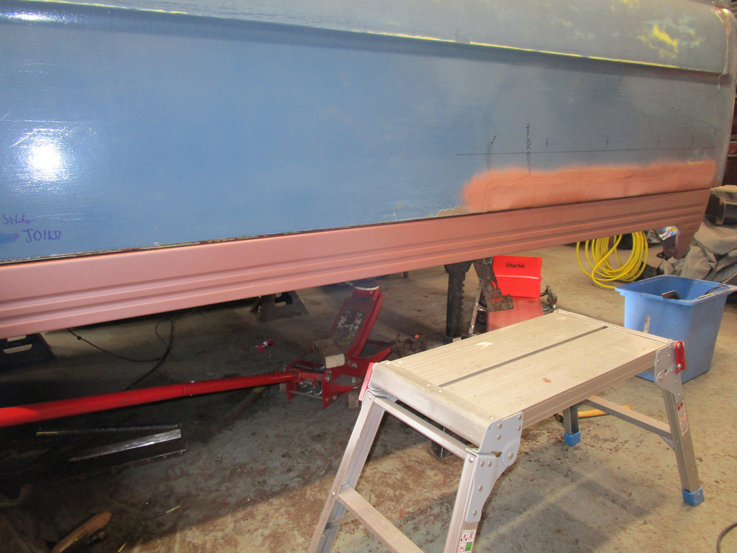

You will also see I have put the new inner sill in place. The fit of the panel is amazing, great work from Martin. I haven't welded the inner sill in yet as I will be replacing the front inner sill.
I am a long way from fitting the new outer sill, but I did lift it into position briefly for a bit of a boost. Again, the panel bought from Martin is fantastic
