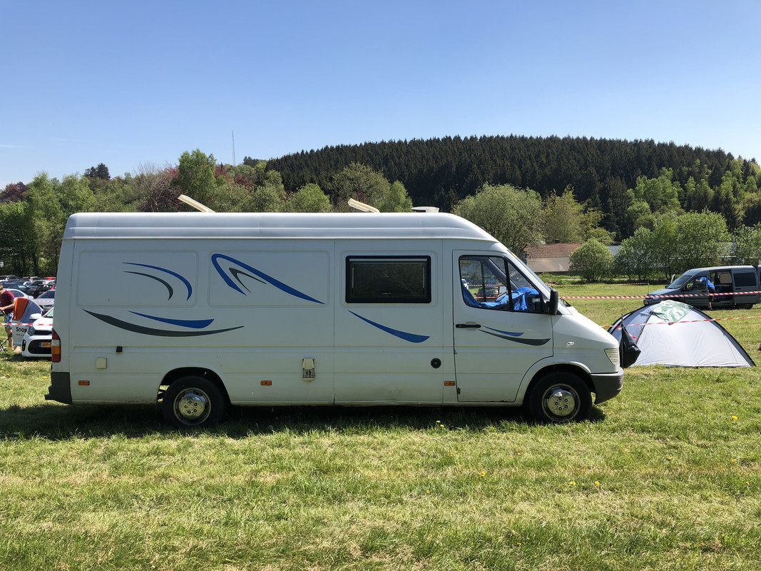

Mercedes Sprinter Camper
Bought 10 years ago. I used to compete in motorsport in sprints and hillclimbs and this was used as my support vehicle. I no longer compete so now used for weekends away and annual trip to spectate at Le Mans 24 hour. It has needed welding a few times and plenty of mechanical work.

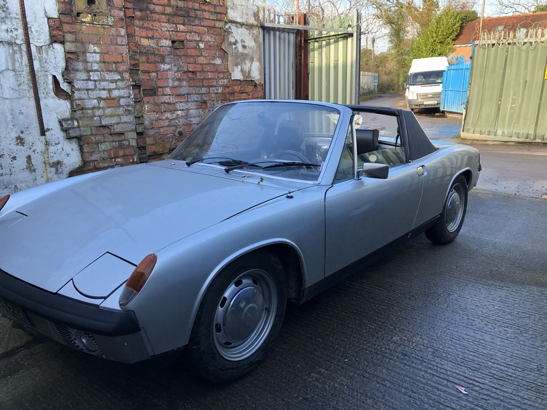

Porsche 914
Bought 6 years ago. An eBay bid with a story! Can was in California, so had it imported and have carried out a full nut and bolt mechanical restoration, engine build and complete body overhaul, with paint by a professional

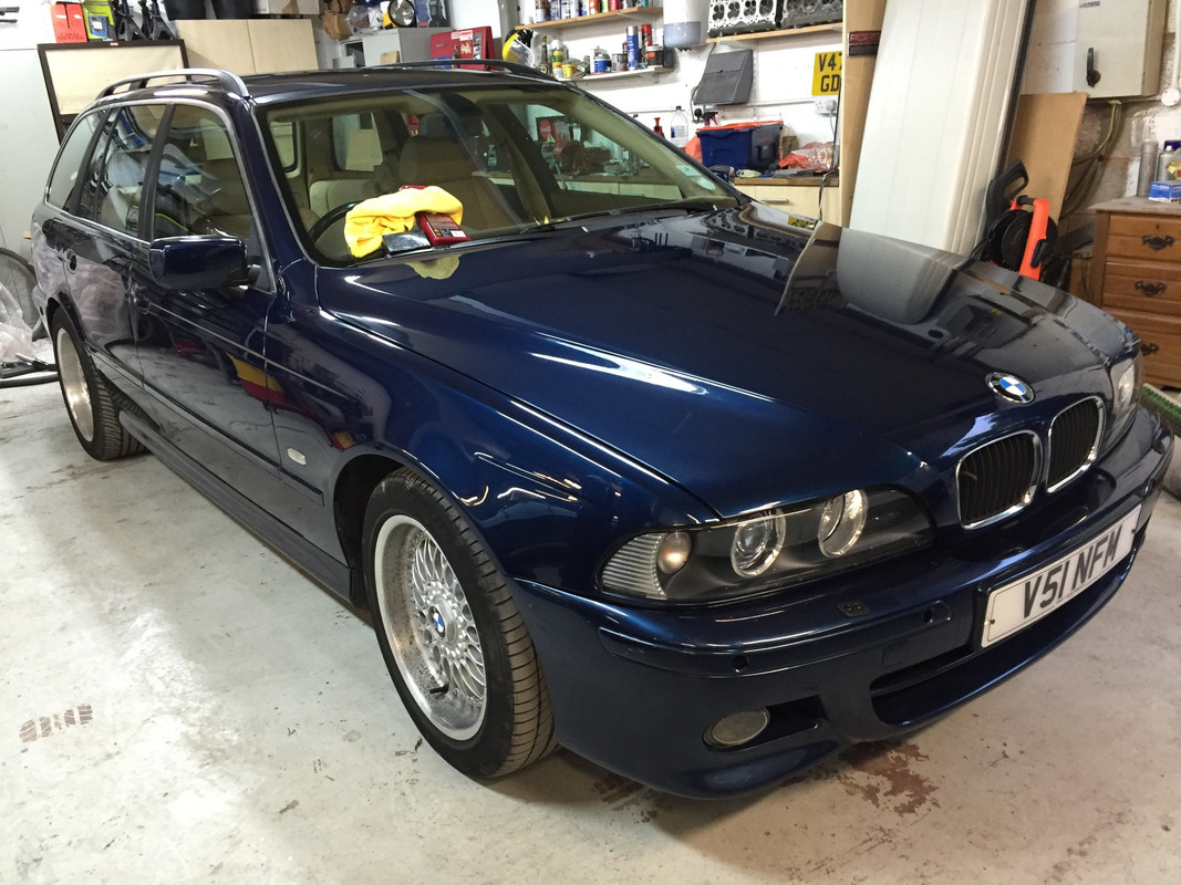

BMW 540 touring
Bought 5 years ago. It was a cheap car to buy. Plenty of work done since to get it to a reasonable standard. My most versatile car, daily driver, long distant cruiser, and gets used as a van for ferrying car parts. Photo is flattering, it needs some bodywork.

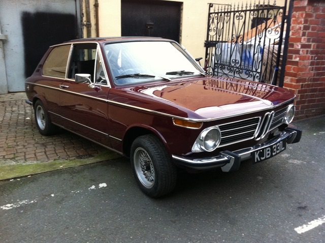

BMW 2002 (2000 touring)
Bought 3 years ago - this is my next restoration project. Again, photo is flattering. Paint is very flat and does need some welding.

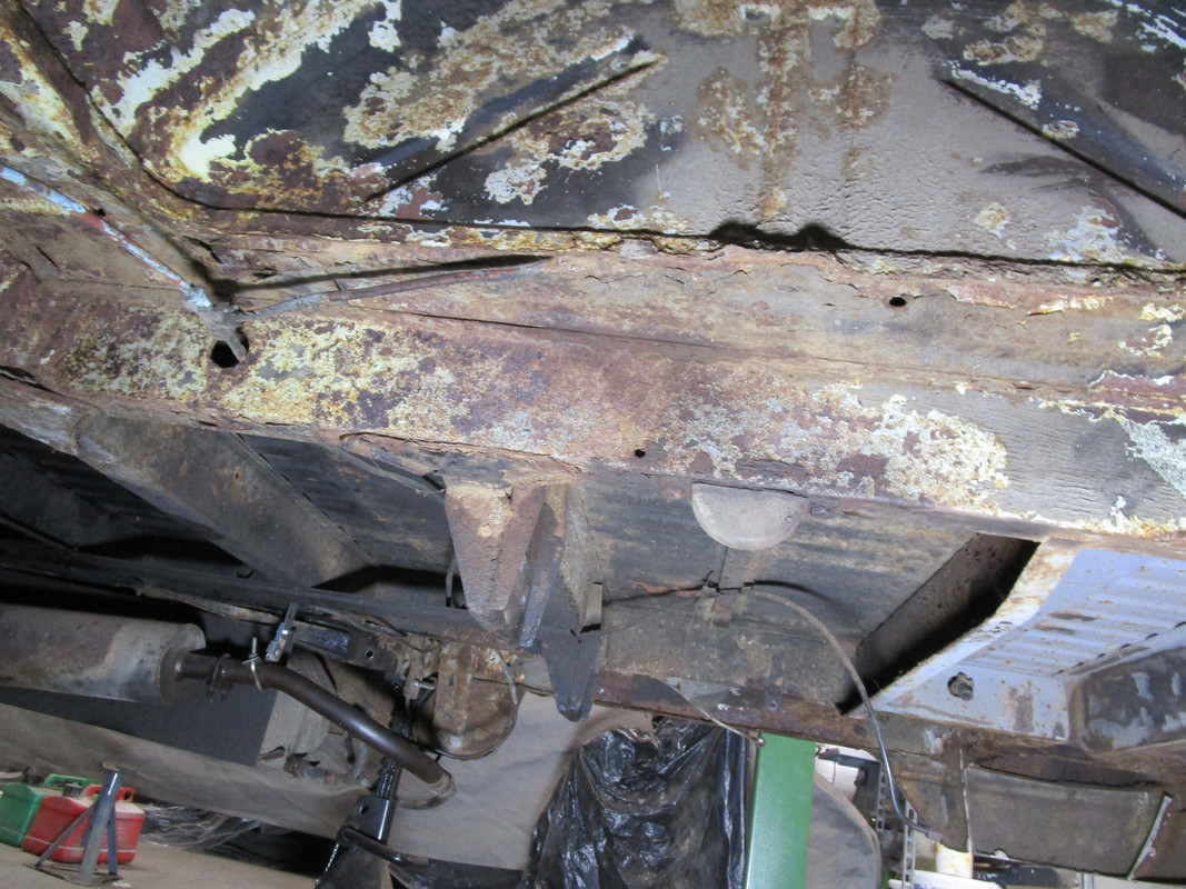

Life has been getting in the way, but I have spent a few hours with the Commer. I have had a good prod and poke around underneath and have a fair understanding of where I am at.

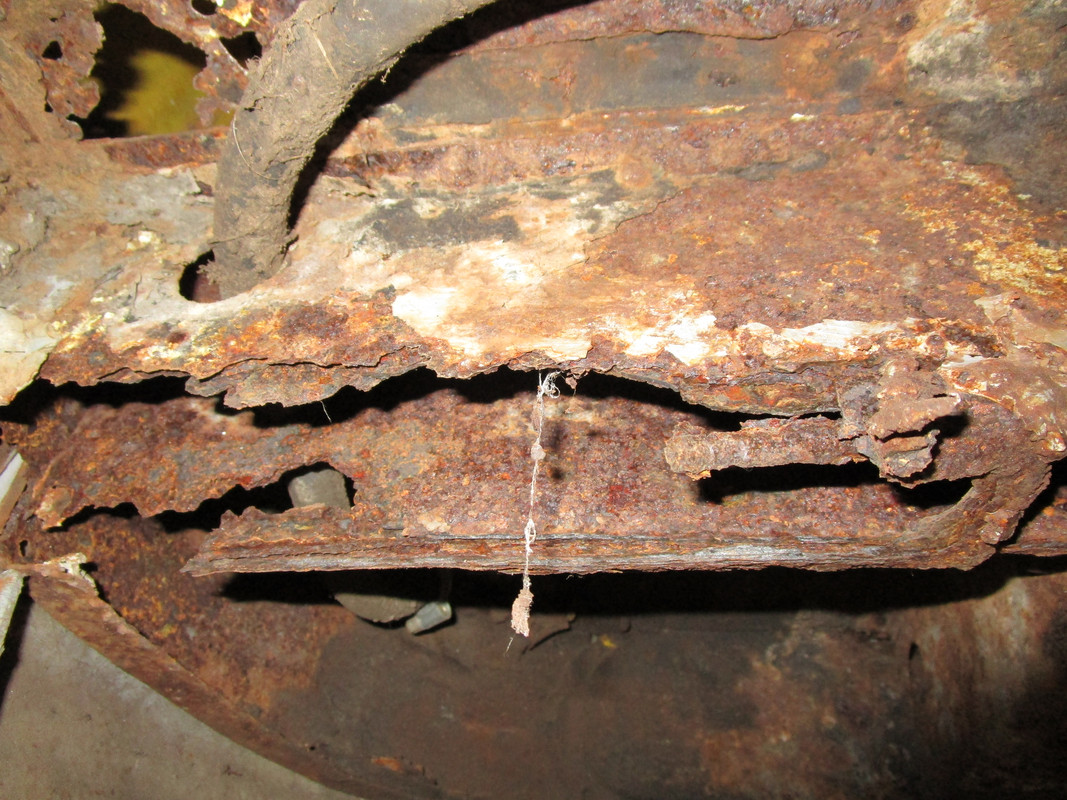

Wheelarch before any cleaning

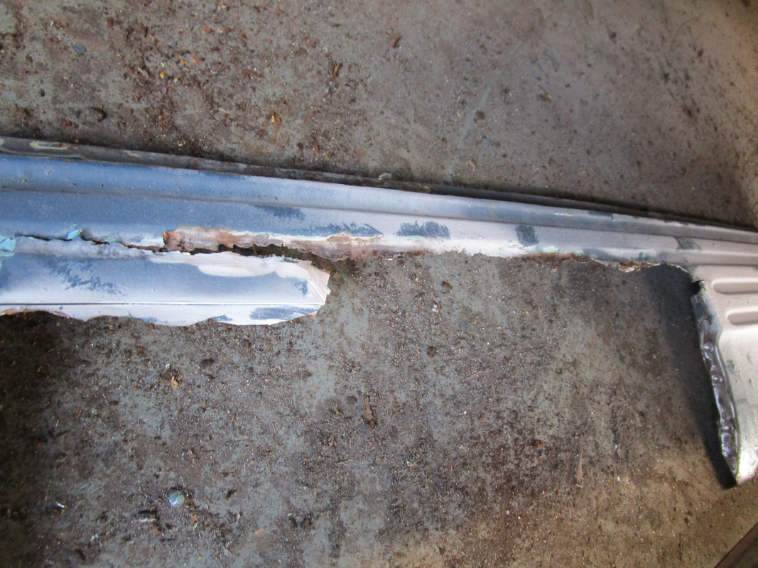

And after a run around with a wire wheel
i was pleased I found mostly metal. Some repairs required, and some dodgy previous repairs need removing, but overall, not too bad, or at least, not as bad as I was expecting
The front spring hangers after the first clean up appear to be very good

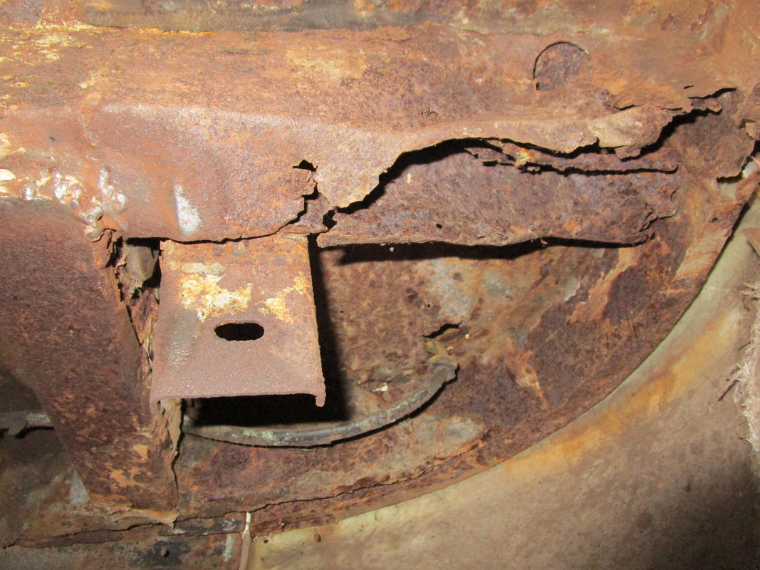

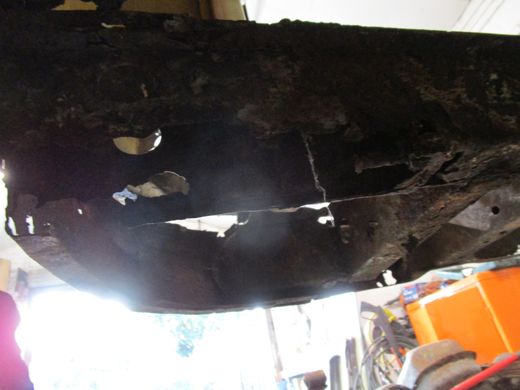

The rear spring hangers definitely need work!
Some welding has been done in the past in that area, and not very well

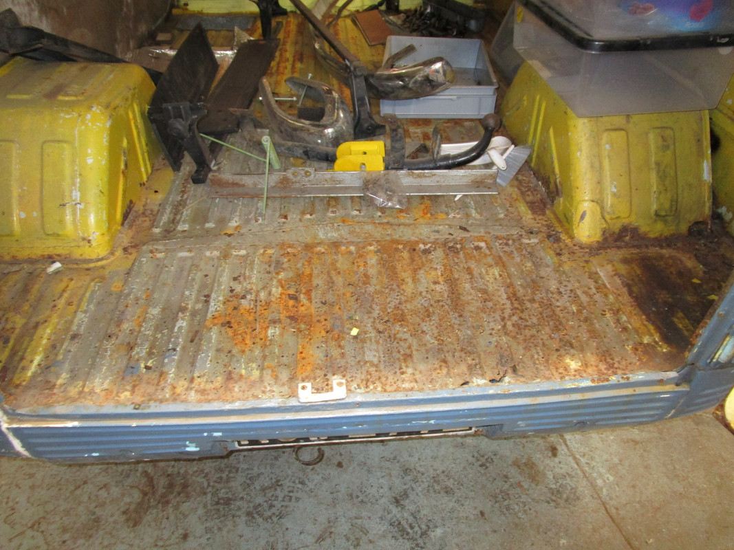

The rear section of the floor also is past its best, with plenty of patches welded over

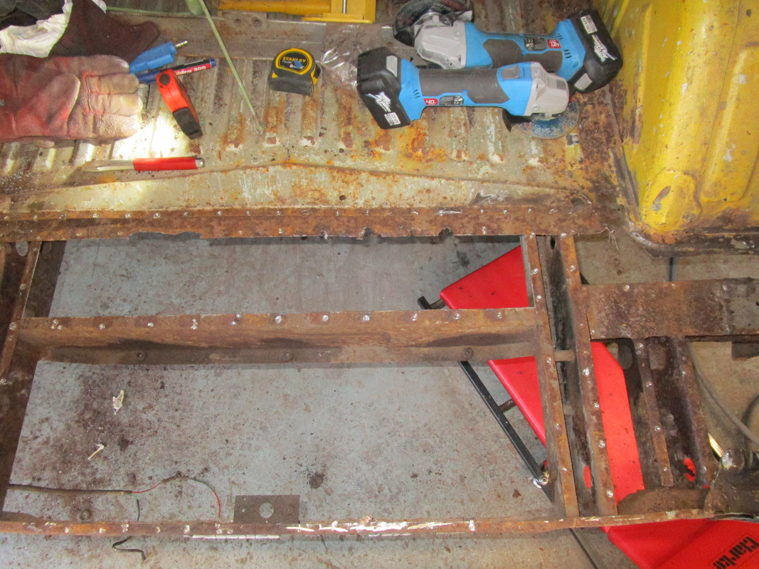

Given the condition of the floor and the welding needed to rear spring hangers, I figured it made sense to remove the floor. After drilling out many spot welds, I was left with this.
I was intending to save the rear panel. But I found that someone had carefully rebuilt it in filler many moons ago. I'm amazed how well they had sculpted the flutes in the bodywork!
I have been around the chassis rails and vacuumed the loose rust out. Next job will be to properly wire brush the chassis members that don't need welding, start applying rust treatment, and order lots and lots of new parts. I think mission creep is starting!
